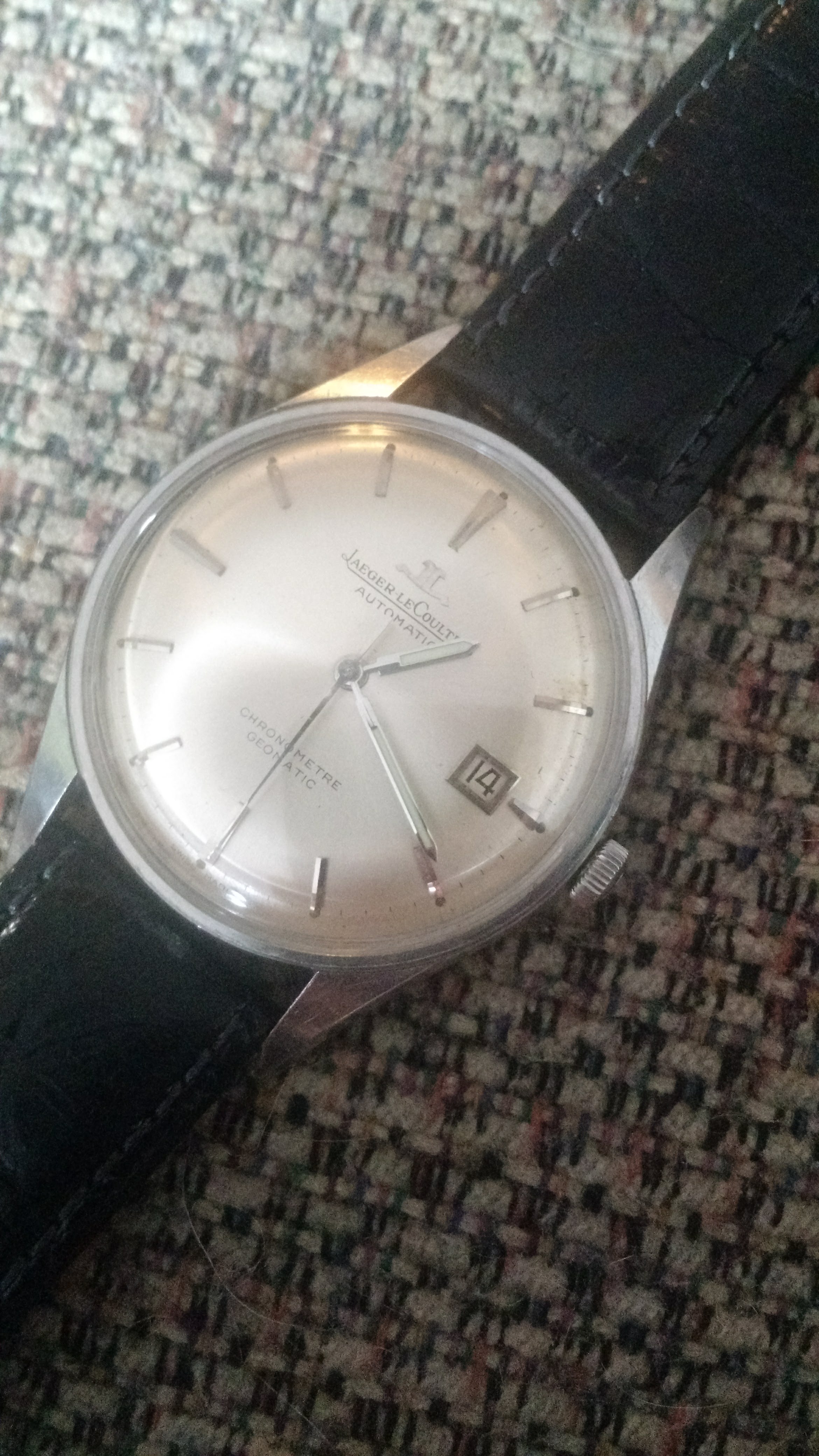

Hi Zaf,
Thanks for your kind reply. I have attached an image of the Geomatic. I think the hands are not original. The style and length are incorrect. The lume is bright.
Re: Geomatic hands
Postby zafbasha » Wed Mar 14, 2018 1:33 pm
Yes, not correct. The cal 881/883 hands will fit and I'm pretty sure some no Geo dress watches have the same.

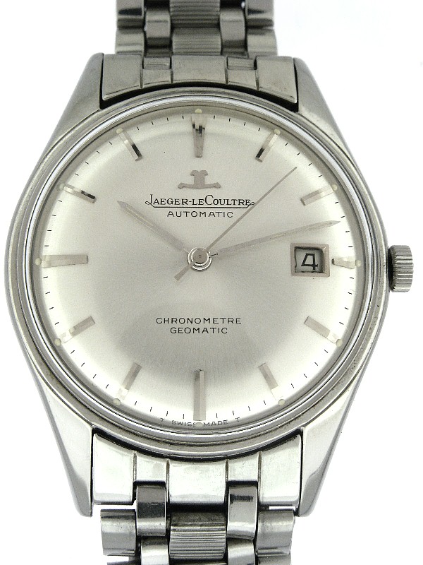

Postby zafbasha » Wed Mar 14, 2018 4:14 pm
Check this:

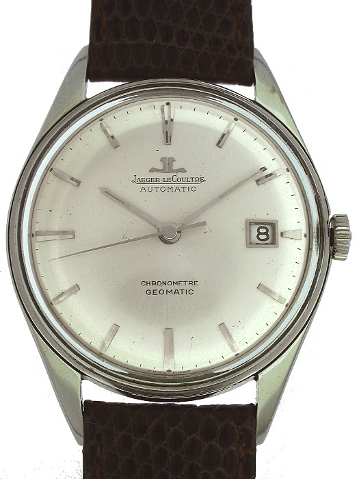

Re: Geomatic hands
Postby zafbasha » Wed Mar 14, 2018 4:18 pm
And this:

Re: Geomatic hands
Postby OutOfSpec » Wed Mar 14, 2018 5:26 pm
Thanks for this. It looks like it will be quite an expense either way to get those hands, unless I use a watch I already own. :(
