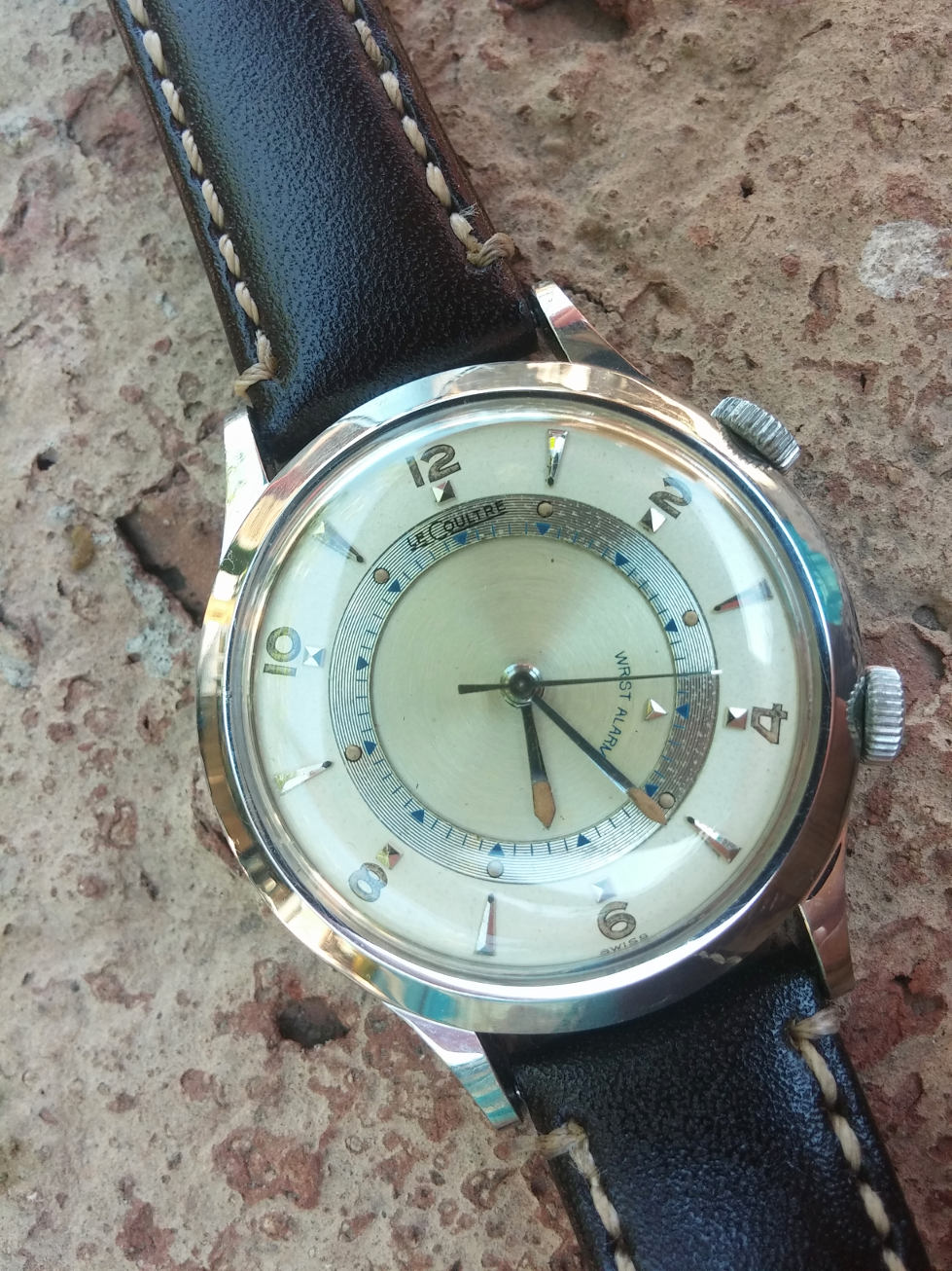

Whilst awaiting my copy of your book, I have started to look for suitable Memovox examples.
Could you give your opinion of the attached. To me the "lum" looks a bit strange on the hands.
As it is just "LeCountre" does that indicate an American cased version?
The seller is asking $1450.
Thanks

They frequently did that re: the lume, so it's OK. It's definitely a USA market watch.
If it's really pristine and all original $1450 is OK, perhaps still a little high, any condition issues subtract vigorously from there.

Zaf,
Thank you for the response.
It does look very clean except for the stainless ring around the alarm dial. Somewhat eccentric to put the lum. dots on the odd numbers.
If I assume around $1200 for a manual / +50% (?) for an auto and double for 18K I would not be far out?
Are there any differences in value between the 50's wrist alarms and the later Memovox ?
Thanks for your patience!
Vince

For USA market watches you're in the right ball park. The gold ones are usually 14k in the US though.
