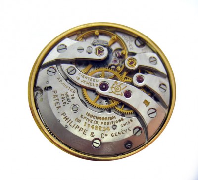

OK, I just took a look at the movement (photo attached) and sent a message to my watchmaker regarding regulation. If all of the regulation needs to be done via the Gyromax screws then it's tricky! You can see the screws on the balance and you will have to turn each one individually to get good results and make sure everything stays in balance. If there is a more generalized regulation (I see what appears to be an eccentric screw next to the balance staff jewel), then it's a simple task.
Let's see what my shop says and we can possibly do it for you inexepensively. Regarding a full service, on a watch like this, we typically charge half what you've been quoted, even less if it goes smoothly.

Watchmaker just replied: "That's a free sprung balance. The adjustments will have to be made on the balance itself."
So I'm afraid there is no really cheap way out of this. It would not be a bad idea to service it to be honest since you don't know when it was last done, assuming you can get a reasonable quote. It shouldn't be more than $200-250 over a normal watch.
