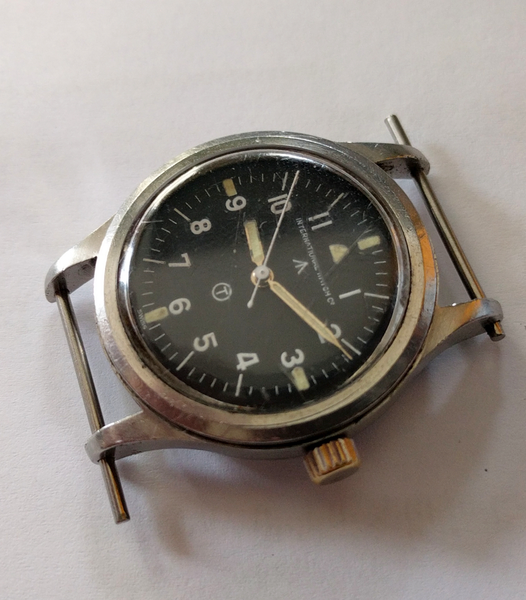

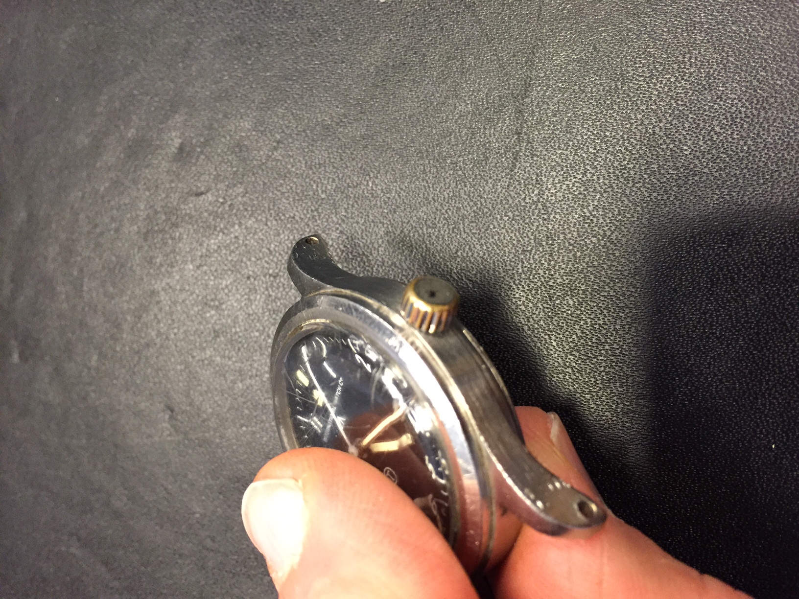

This will be a fun project, so I thought we'd do a little write up. This is how I received the watch today...
The watch had it's fixed bars drilled out, the wrong crown, a totally beat up crystal and is running sluggishly.
BUT ... lurking under there is a rather nice dial.

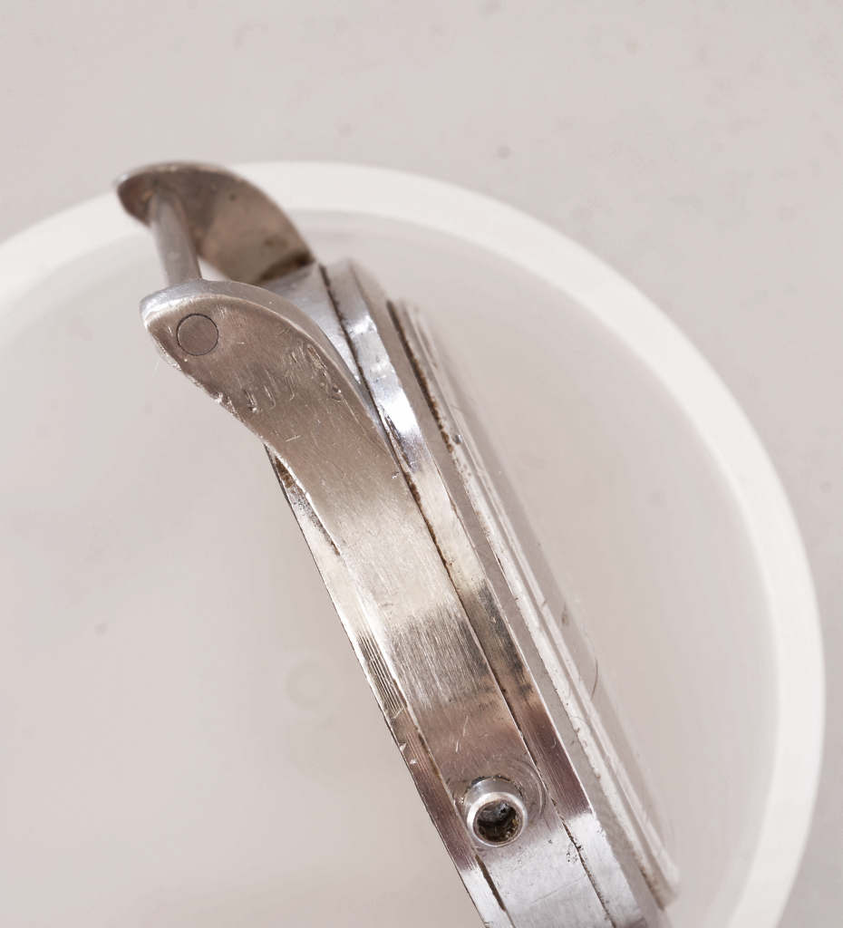

DAY 1:

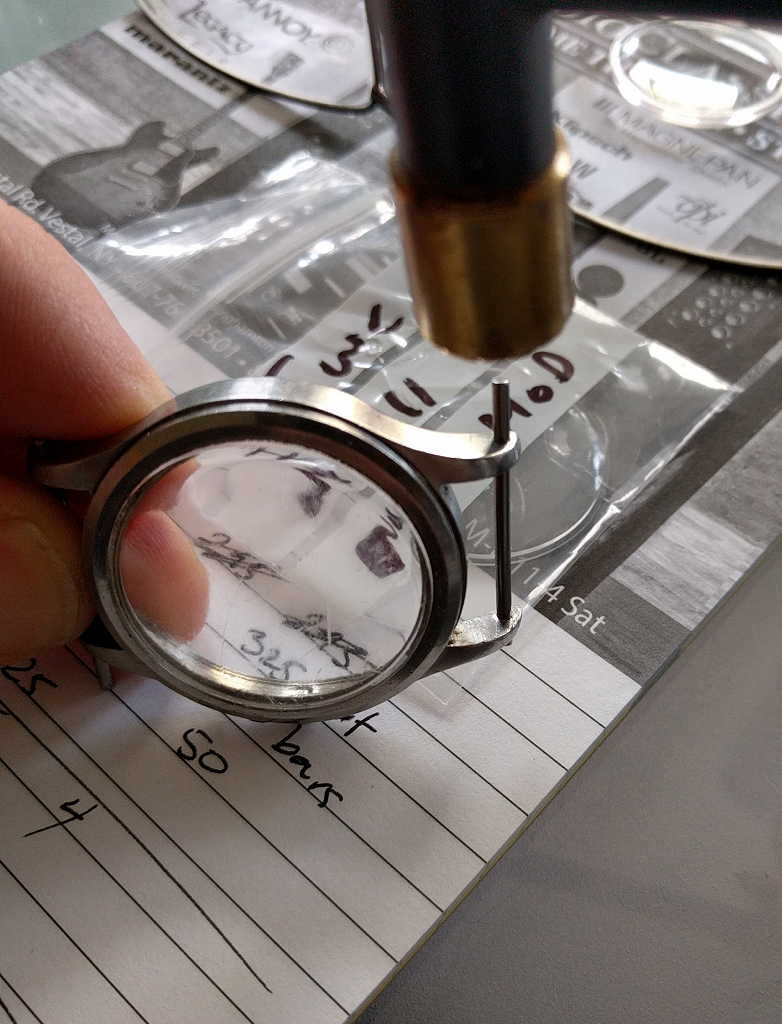

A bit lucky, but I have in stock 1.5mm bars. Exactly the right size for a nice compression fit on the existing holes.
With the MOVEMENT OUT you can drive them into place. The driven side will mushroom out a little, which the side I will likely leave unsoldered.

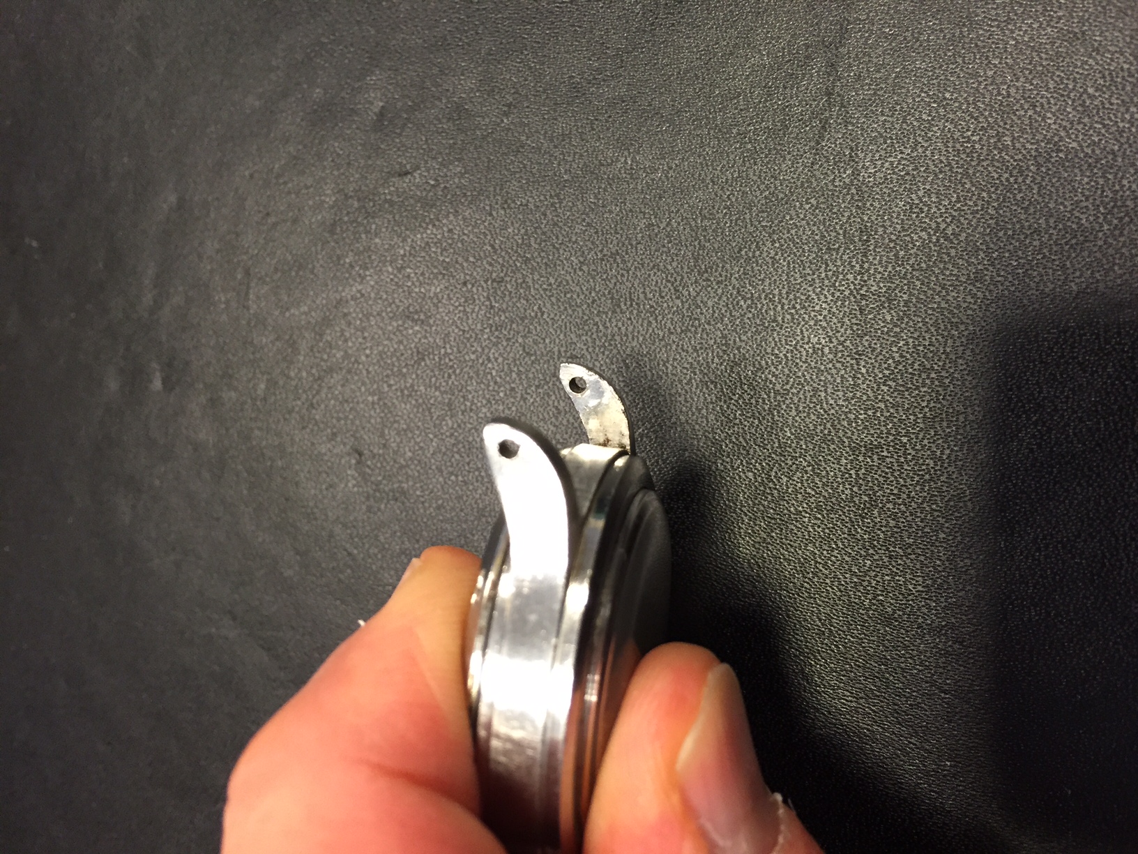

This is what it looks like with the bars in. No to cutting them down to size....(trickier than you'd think).

This is what it looks like with the bars in. Now to cutting them down to size....(trickier than you'd think).

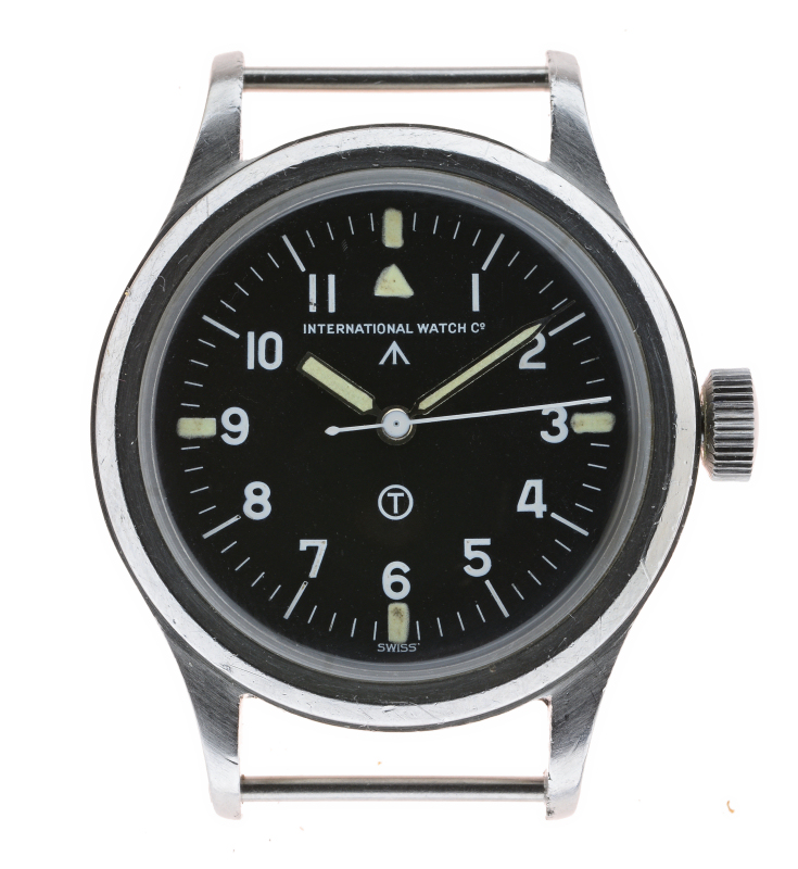

Post by zafbasha » Mon Apr 11, 2016 6:02 pm

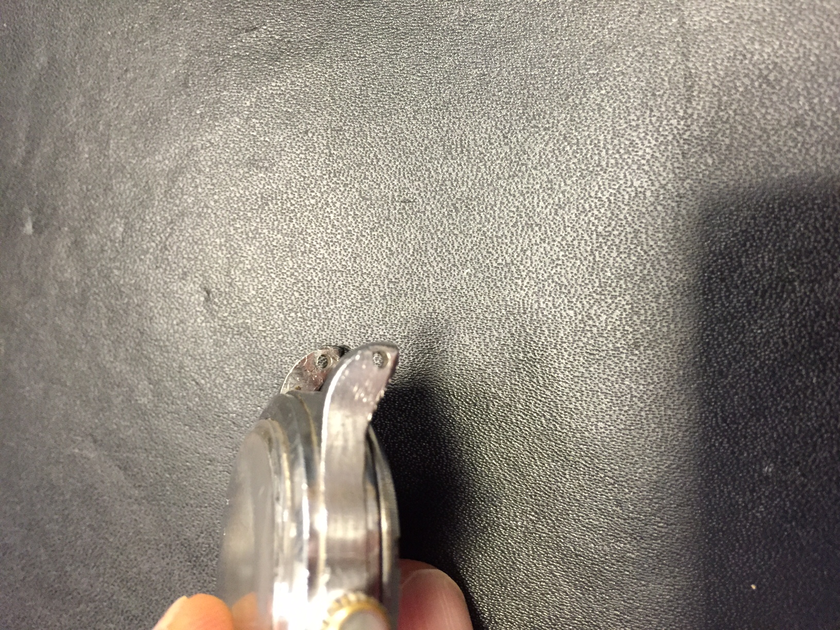

The fixed bars are in, I was fortunate to get a very good pressure fit, so I didn't even need to tack them. Almost like they were never off!

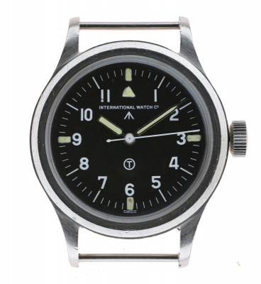

Post by zafbasha » Wed May 04, 2016 11:26 am
Here we go, back from a complete overhaul mechanically, NOS crystal and NOS crown. Not a bad result if I may so so myself!
