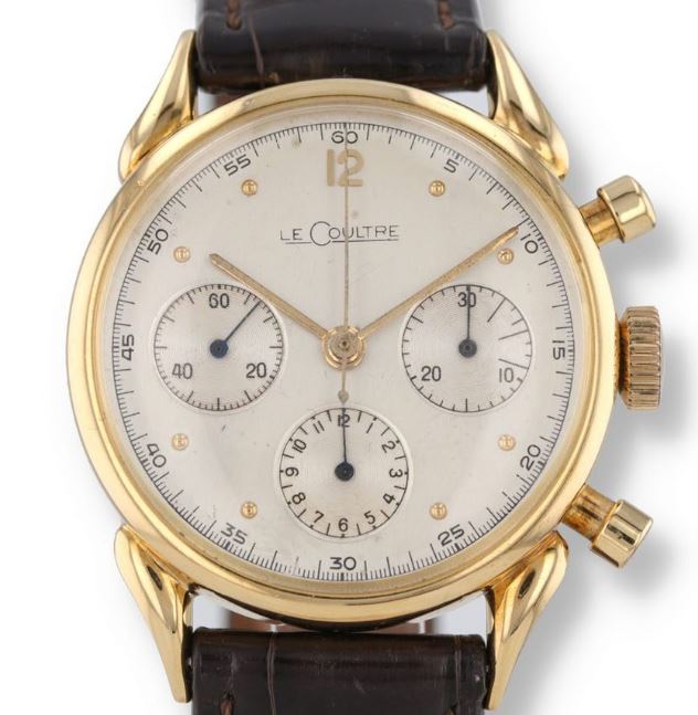

Hi all,
I came across the watch below and I had two questions:
1) There aren't a ton of examples that I can find of these JLC triple register chronographs with horned lugs. This looks very similar to the example on page 79 of Zaf's book, but the sub-dials look different (they resemble the chrono on page 78). Does anyone know if this particular dial configuration was used on this reference, or is this likely a restored dial? Also, the hands don't look quite right vs. the example in Zaf's book.
2) The movement referenced is a Valjoux 71, but I thought JLC's used Valjoux 72s in these chronographs from the mid-fifties. Does anyone know if Valjoux 71s were used as well?
Thank you!

Postby zafbasha » Thu Apr 23, 2020 5:51 pm
Hi, it's definitely a Val 72. I can't tell 100% on the dial, but I am leaning towards it being restored form photos. Should have SWISS at 6:00 on this model.

Postby daniel5050 » Thu Apr 23, 2020 6:30 pm
Thank you! Really appreciate the response.
It's a quirk of the picture, but there actually is a swiss at 6 o'clock, just impossible to see the way the watch is photographed. Was there anything else that jumped out at you as far as pointing towards a redial?

Postby zafbasha » Fri Apr 24, 2020 9:56 am
The LeCoultre itself seems malformed and listing down to the left, but that may just be the photo. Print on these should be sharp and black in tone, not a milky gray. You really need to have it in hand to be sure.

Postby daniel5050 » Fri Apr 24, 2020 10:50 am
Thanks Zaf,
You're right - the LeCoultre itself isn't quite right, the "L" in particular looks off under a loupe. Back to the dealer, who's being very reasonable. Disappointing as it's an amazing watch.
If on the off-chance you have a source for an unrestored version of this reference I'm definitely an interested buyer. The case shape and lugs are beautiful.
