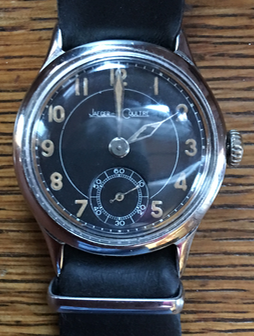

Posted: Wed Jan 27, 2016 12:27 pm
by marcus
Funny - I have just purchased a very similar one... as authentic as they get I think with a little damage to the hour hand but thats age for you I feel... runs like a dream!
Re: JLC 463 Military Style Watch
Posted: Wed Jan 27, 2016 12:38 pm
by marcus
Slightly better dial image I think
Screen Shot 2016-01-27 at 17.37.56.png (195.2 KiB) Viewed 46336 times
