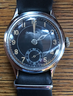

Good afternoon,
I would love to hear some of the expert's opinion on the following specimen I'm interested in purchasing. Everything looks correct and original to this untrained eye, but could really use the help!

The case has been replated. Dial is original.
On this model, atypically, the case back # should match that of the movement. Rumor has it that it was a Luftwaffe delivery, but that theory is still in the rumor stage. No one has been able to prove it for sure.

Thanks zafbasha. Does that mean a)the case back is not original or b) it couldnt possibly be a Luftwaffe because the numbers dont match. Lastly, how bad does the replated case affect the value?

Though it is the correct back, I think the back is from another watch or the movement came from another watch. Replate is less than an original in good condition, better than a trashed case. These chrome plated tops usually didn't last too long before showing wear.

Guess Zaf is speaking of the s.c. Wehrmacht Jaeger-LeCoultre watches, but they have a slightly differend brand layout on dial. These MUST have matching case and movement serials, house a 463 without '/A' indication. Caliber inscription is stamped into barrel bridge not unter the balance.

Yes correct the dial is more in block letters, on the German delivery model, my error. This one is 'civilian' all the way.

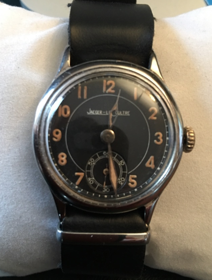

Funny - I have just purchased a very similar one... as authentic as they get I think with a little damage to the hour hand but thats age for you I feel... runs like a dream!

Slightly better dial image I think
