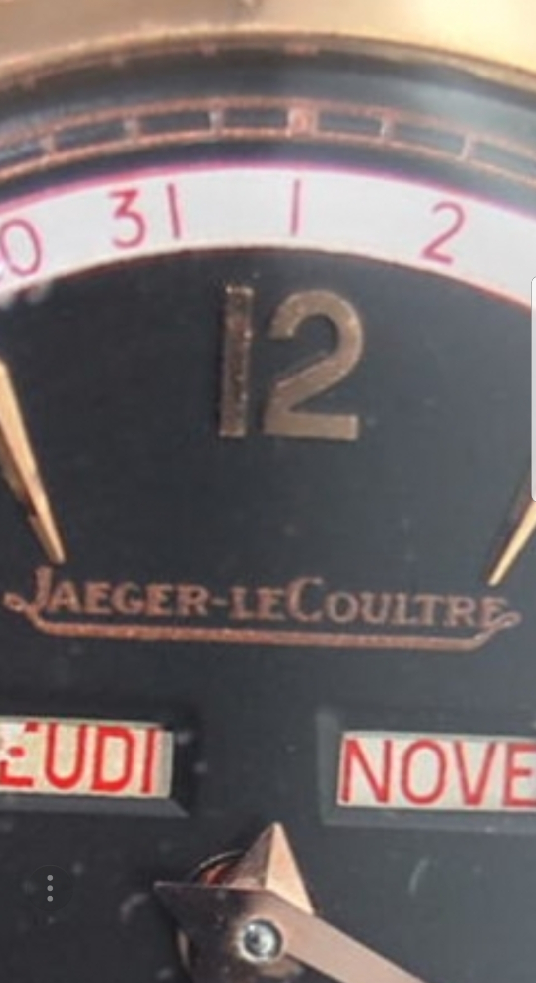

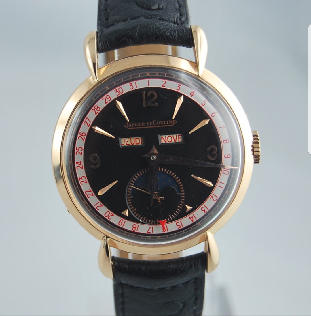

Hello, I need help with this Jaeger calendar moon phase.
What do you think about?

Good chance that is a refinish.

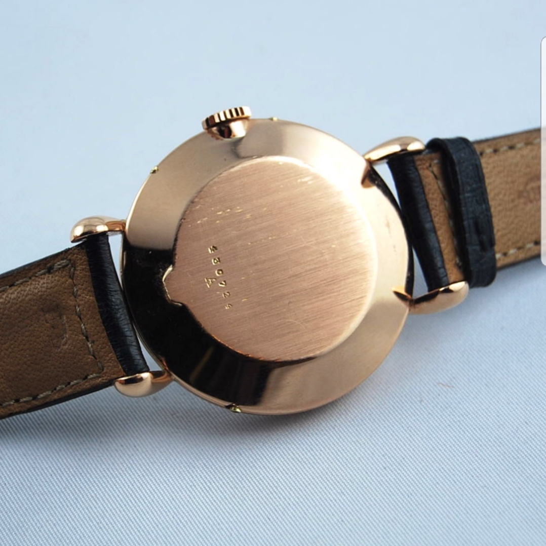

Postby Anite » Wed Oct 03, 2018 3:12 am
Thanks, here some other photos...

Postby zafbasha » Thu Oct 04, 2018 1:20 pm
I'm pretty confident that dial has been refinished, but hard to say 100% with the photos being a little blurry. Typically, on the 1-31 of the calendar, the 6 and 9 are open, not closed. The tick marks on the sub seconds are not that heavy. It's a good job though, just some details appear to be off.

Postby Anite » Thu Oct 04, 2018 5:15 pm
Thanks Zaf, the dealer who has the watch for sale in Italy says that he bought it from a man who worked in JLC and he found that dial in nos condition in a warehouse...
I will ask for better photos.
