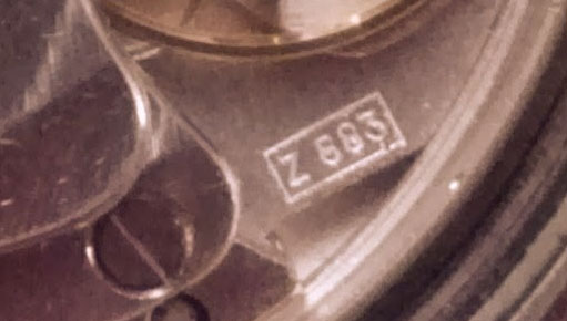

Thanks, Zaf. Below is a picture showing "Z883." The balance has kif shock protection, but it still says "z." I tried to research this "z883" and did not find much.
Thanks for letting me know about the hands and that they would fit (even from a "z"?). I'm not sure if I want to take apart this watch, what I'd then do with it, or if it is even advisable to do.

Postby zafbasha » Fri Mar 16, 2018 10:26 am
This is on the MM or Geomatic?
The Geo should be either a K881G or a K883G. The movement should hack set. Does yours hack set?
I've never seen a Z883 on a geomatic, though anything is possible I guess!

Hi Zaf,
Sorry for the confusion. Both movement pictures I have posted in this thread are of the Master Mariner.
It is the Master Mariner movement that reads "Z883." I cannot find much information on this movement.
My Geomatic does hack set. I can't open the back, so I can't post a picture. I have been researching Geomatic calibers here: https://www.watch-wiki.net/index.php?title=JLC_881
I thought the stainless steel Geomatic may be a K883 S. I'm confused by the possibilities.

Postby zafbasha » Mon Mar 19, 2018 11:14 am
Yes, K883S or K881G for Geo, typo...
